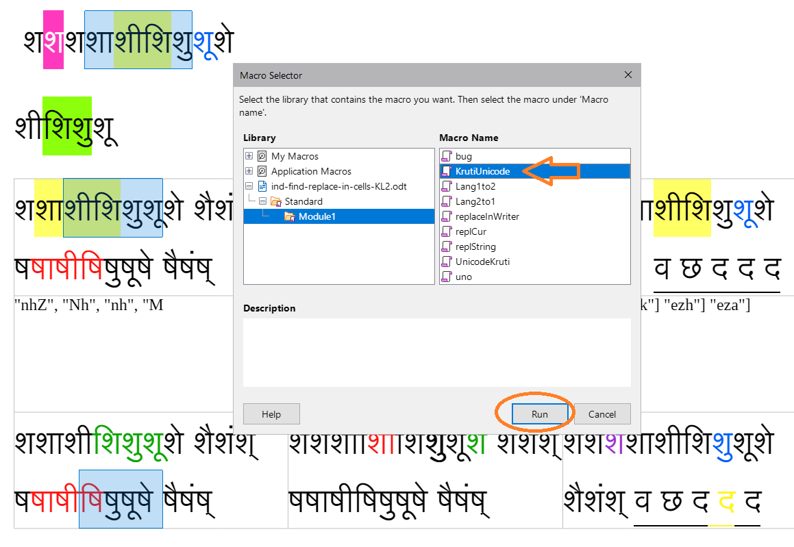

2nd prototype for Writer, it should be functional also for normal selections in normal text and also for multiselections.
ind-find-replace-in-cells-KL2.odt (49.0 kB)
I removed duplicities from F&R arrays and sorted ones according to lengths, but the conversion still isn’t 100% reliable now :frowning:.
F&R in Calc are still problematic :frowning:
Not working at all.
It really easy to write only:
But where it doesn’t work? In some cases in my randomly created ODT? Or in some your documents? Where and at what activity?
Nowhere. I tried to type some kruti dev and some unicode text in your document. Then select it and try to run macro but it is not converting. I tried it in cells and also tried it in outside the text. After opening your document it is showing error "Please install the hyphenation package for locale “hi-IN”. Does it has something to do with the functioning of the macro.
Did you run the macro(s) KrutiUnicode or UnicodeKruti? Because it is fully functional for me
The message with hyphenation package is because you didn’t upload example ODT with KrutiDev and Unicode, so I randomly copied some parts from substitution-arrays and selected lines with ones as Hindu language with the font Lohit Devanagari (because without this font it wasn’t well-visible for me). But it hasn’t influence on macro running.
Edit: I discovered the conversion isn’t 100% reliable in prototype 2 :-(, sometimes there are some problems after conversion for Kruti2Unicode and then back Unicode2Kruti.
There are the collisions in substitution table! It is about 70 collisions that causes the bad transformation.
conversion-table.ods (33.9 kB)
Run the macro Module2 / findProblems from ODS to see the lines and Ascii codes of problematic substitutions. Then it need fix all these problematic substitutions.
It is working. You need to select Unicode text and choose the macro replaceInWriter macro. It will convert the Unicode text to Krutidev. But KrutiUnicode or UnicodeKruti macros are not working.
