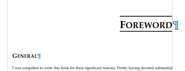

For example, the following heading formatting (top and bottom borders)
cannot be done by configuring only the paragraph style because the Borders tab provides only paragraph borders. There is no Borders tab for the “companion” character style.
If such borders are set in the paragraph style, top and bottom lines extend from margin to margin. By configuring the same borders in the character style, the lines will only surround existing text. Empty space is neither overlined nor underlined. I find the result nicer than with full width lines.
This is perhaps worth an enhancement request to make the “companion” character style a full-fledged character style, eliminating the need to apply a separate char style.
