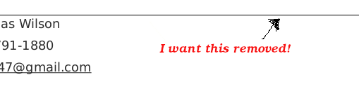

I have a Ubuntu 20.04 Laptop (up to date on patching). I have the Libre Office trying to create a docx document. The entire document has a frame around the text (i.e. text box). from what I have read how to remove this stupid thing it does not work. I do not want a frame around my words in a cover letter (example).
Here is an example:
Well, it’s not clear from the screeshot excerpt what it is, unfortunately.
It could be, a table, a frame, a text field or a range area.
Please upload a reduced and anonymized file, where the problem is present, here, so someone can examine it.

Your documents are plagued with direct formatting, formatting manually added. To get rid of everything, Ctrl
+A
, then Ctrl
+M
This will remove the border on all paragraphs.
You probably copied your text from some web site because the font face is configured the same as in CSS for HTML pages. I.e. you have a preferred font face/family, followed by fallback faces/families separated by semicolons. This specification doesn’t work with Writer. You can specify only one font face in a style.
Anyway, clearing direct formatting will also clear this (bad) customisation, reverting to the default font on your computer.

Worked perfectly Thanks!
