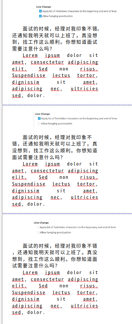

You are looking to let punctuation be out into the margin but in my version 24.2.7.2 it’s automatically done for some texts.
I am looking for the reverse, to not have punctuation be out into the margin, but I don’t find which option is provinding the choice.
My text is in chinese where punctuation are “full-width” but it shows LO is able to apply, at least on the right margin this “expected by you” and “unexpected by me” behavior.
So why not having an option to choose if applied or not.
Text of the sample is

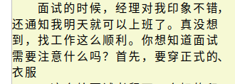

面试的时候,经理对我印象不错,还通知我明天就可以上班了。真没想到,找工作这么顺利。你想知道面试需要注意什么吗?首先,要穿正式的、衣服
Chinese font is Google Sans Mono CJK, here is the graphical result
Screenshot from 2025-06-03 08-54-35

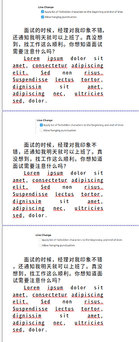

Hi Ajlittoz.
Diiging deeper I found the expected option, unfortunately it’s applying only on chinese like content.
So for chinese like content three choices are efficients
  • put punctuation in margin
  • put punctuation at the next line
  • put last character and punctuation at the next line to avoid starting a line with a punctuation
Unfortunately these options are not available for non chinese like content, I tried to enforce chinese like behavior to lorem ipsum without sucess.
