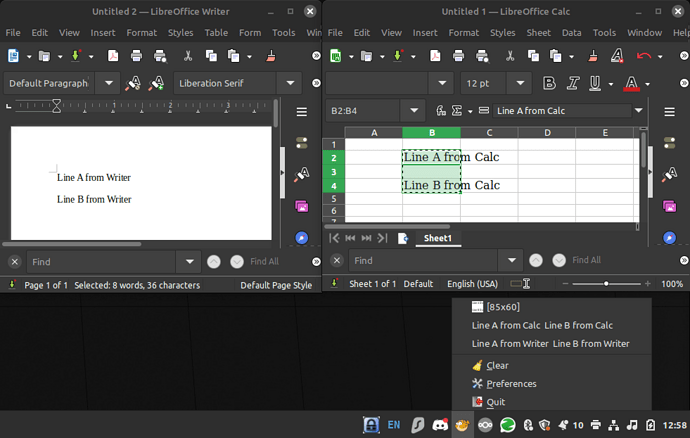

  • I installed Diodon to see what was happening with the clipboard. It does reveal something interesting. When I copy text from LO Writer, one text clipboard entry appears in Diodon. When I copy cells from LO Calc, two clipboard entries appear in Diodon–a text/cell entry and an image entry:
    If I then select the text entry in Diodon, the Text Import dialog pops up in Calc and the cells get imported correctly:
So what seems to be happening is that copying cells in Calc performs two copies–first as text/cells, and then second as an image. Since the image copy is the last action, that is what gets pasted.
