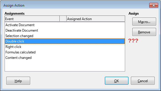

I don’t understand - why Content Changed? You want to handle double clicks, don’t you?
DblClick_Event
To Lupp : Using pEvent.supportsService and pEvent.AbsoluteName seems to be a good track. Thank you.
To JohnSUN : As much for me, please read “Double click” instead of “Modified content” (or “Content changed”). Thanks for your help.
