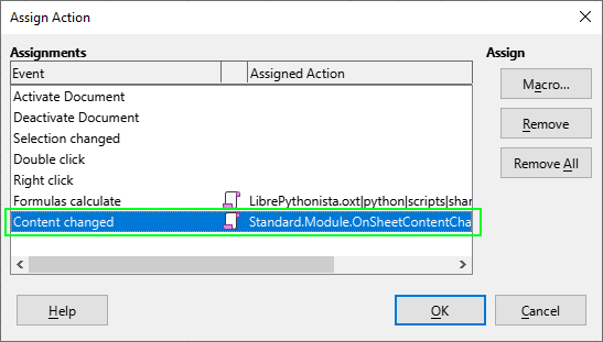

It must be a Document scope (level) Event, because the old Sheets will not be changed when a new one is created. The peredefined Document-level and Application-level Events are available in the Events TAB of the Customize panel.
And you can create new Events (see the documents linked in my previous posts)

I’m probably missing something, but… I opened the fixed version, and I see the EH macro code there. But I do not see any events connected when I open, Tools > Customize … which event is it that I should be thinking about there?

My sample is for ASSIGNING A MACRO to a SHEET EVENT. The sample macro will launch on the Button Event.
YOU must find or create an another Event (of the document) for automatic launching the macro to create a new sheet, and assigning the parsing macro to the sheet event.
