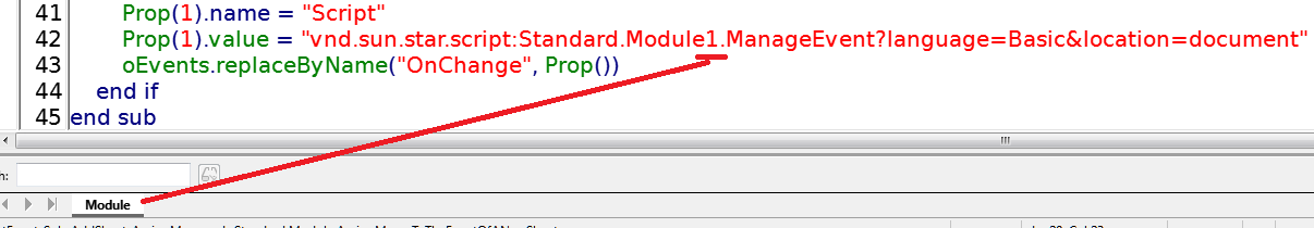

Here is my new sample file. The new macro (assigned to a Button) will create a new sheet named ā€œSheetXā€, and then it will assign a macro to the the desired Sheet event.
SheetEvent_Sub_AddSheet_AssignMacro.ods (18.4 KB)
Good job my friend! Just a small typo - no need for that ā€œ1ā€
Sorry, I have not tried that the assigned macro works or not on the new sheets…
Thank you!
Here is the fixed version:
SheetEvent_Sub_AddSheet_AssignMacro2.ods (18.4 KB)

My sample is for ASSIGNING A MACRO to a SHEET EVENT. The sample macro will launch on the Button Event.
YOU must find or create an another Event (of the document) for automatic launching the macro to create a new sheet, and assigning the parsing macro to the sheet event.
