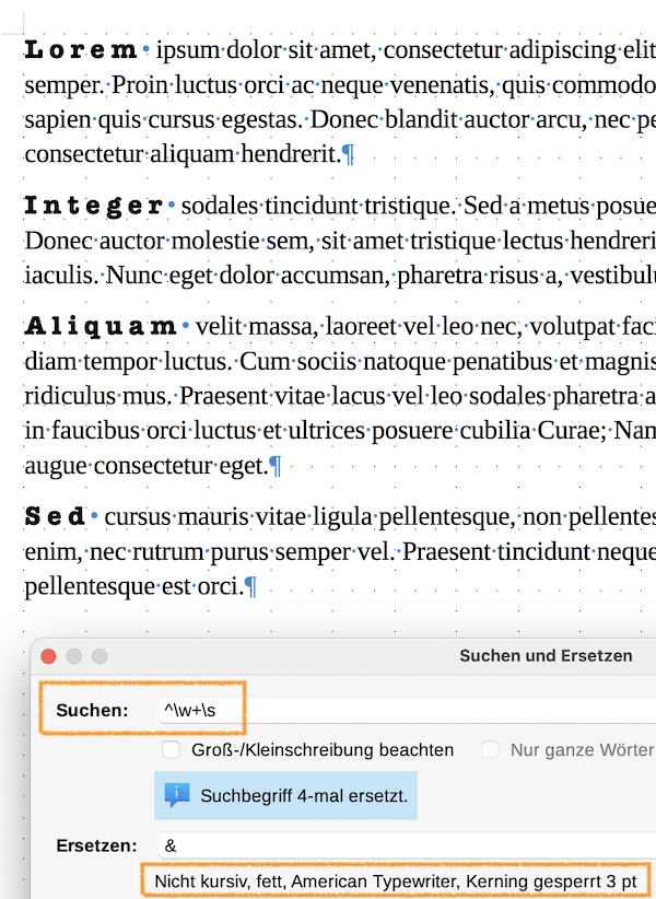

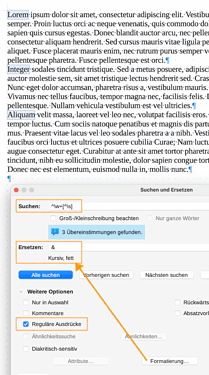

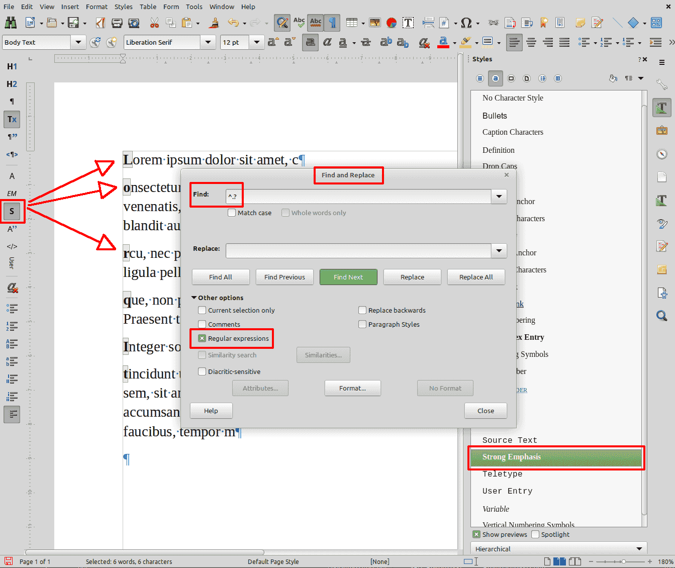

You could use SEARCH&REPLACE tool after finishing your text creation.
Find the 1st letter, then double click on Strong Emphasis (character style).
1st letter is found as 1st letter of a paragraph.
(You may use the Formatting (Styles) toolbar for quicker formatting.)
See attached screenshot:
tdf#70180
It allows that perfectly.
Thanks.

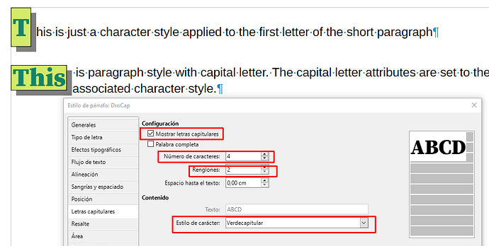

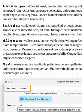

The nearest seems to be “Drop Caps”. Now… if I select that, then I can add a little styling: under “Character Style”, “Strong Emphasis” can be selected. So there is a little styling possible, but not the wider range.
If the paragraph wraps to multiple lines, then the “Drop Caps” works. And it includes that (restricted) extra styling.
BUT… if the paragraph is short and doesn’t wrap then the entire “Drop Caps” styling of the opening letter or word is abandoned.

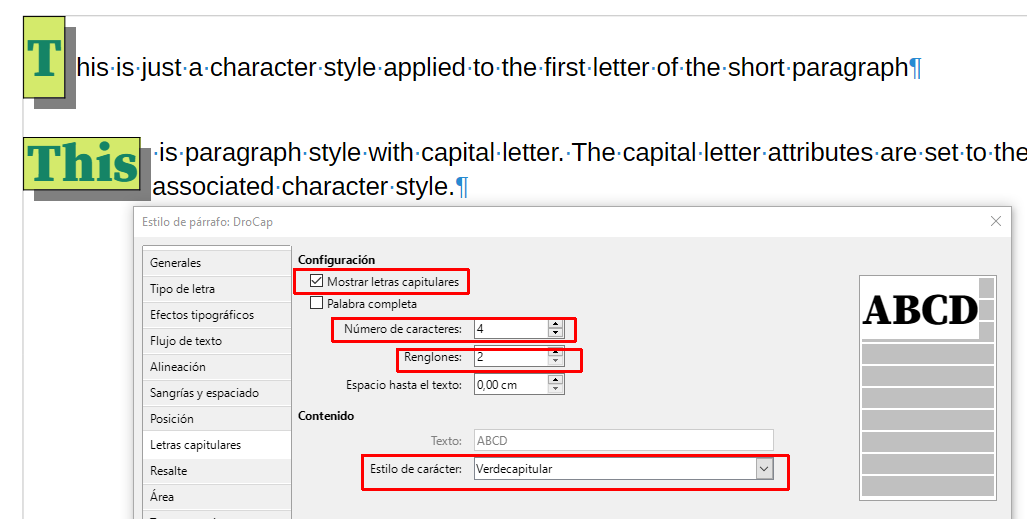

Attached is a screen shot. On the long paragraph things work as expected (Drop; accompanied by “strong emphasis” styling). But on the short paragraph, because the "Drop"ping of the character/word is inapplicable, then also the additional styling doesn’t happen: its “Lorem” does not receive “strong emphasis”.

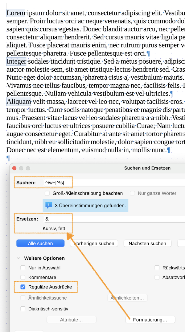

You will find every first word in every paragraph with ^\w+[^\s] and regular expressions enabled within ordinary find-and-replace:
up to the first space
inclusive the first space

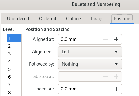

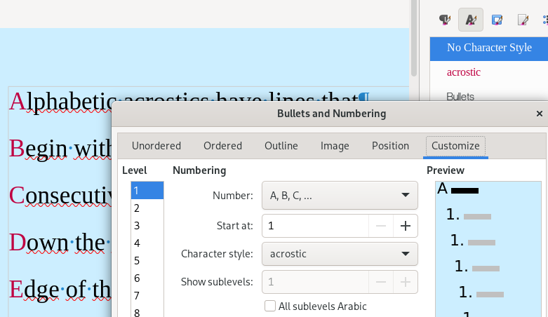

Deleting the first character, and choosing a character numbering, with a character style, does it.
First letter styling.odt (12.1 KB)
imagen

Not obvious which number to choose instead of a letter, but works:
More to read and test:

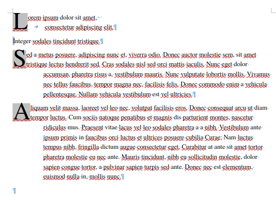

Partly. This is the dropcap feature. But it won’t give the result you expect because it can’t be reduced to operate on only one line.
You configure it in the Drop Caps tab of paragraph style configuration. You associate a character style to the drop cap to format it differently than default. This style can be built-in Drop Caps.
In the example above, if your verses are paragraphs, enable drop cap. The selected character style will be automatically applied to the first letter (if so configured). Note you can’t modify font size. So use other attributes to highlight your first letter.
If your paragraph contain multiple verses (separated by line breaks Ctl+Enter, add a tab after it to indent the second line and have a blank space betwee the 2-line drop cap and the verse. Customise Before text indent and First line indent to create a hanging indent.
See example AskLODropCap.odt (25.5 KB)
The screenshot of the example shows a 2-line paragraph with tab and a 1-line verse. Next is a long paragraph without tab in the second line resulting in a weird look.
a) Wrong. Drop Caps by default is not associated to the feature. You must select it yourself. By itself, it does nothing because it is not activated.
b) Drop Caps can be modified any way you like. When used with the dropcap feature, only font size becomes ineffective because glyph resizing is managed dynamically.
Don’t do that. Direct formatting is the root of all evil. Instead, apply character styles.
That’s basically correct, but if the line is the only one of the paragraph, the dropcap will automatically be reduced to one line.
See also the text in the attached example with additional remarks.
(Remins the missing alignment for the second character…)
disask_129315_1_line_dropcaps.odt (19.0 KB)
The actual behaviour is too complicated as to be describable by me.
