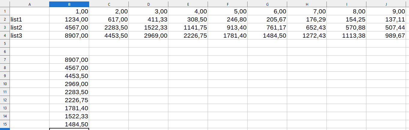

hi. sorry if this has been asked already. in my 20-min research i’ve found some similar cases but not this particular one. i’m a noob with spreadsheets so this might sound a bit obvious or stupid, so thanks for the patience.
so, i want to find a value in a range that looks exactly like this:
B2:B4 range is text, rest of numbers are divisions. for example, C2 is =B2/C1, D2 is =B2/D1, C3 is =B3/C1 and so on…
the numbers below the table are done with the LARGE function. they’re the 9 biggest numbers sorted from biggest to smallest (sidenote: had to change rankC value by hand instead of the dragging doing it automatically, dunno why)
now i want those numbers to have their respective “lists” defined in A7:A15 range automatically. so, for the first number (8907,00) A7 should show “list3”, for 4567,00 A8 should show “list2” and so on.
is there a way of doing this? tried with lookup, vlookup, hlookup, match+index, nothing worked (might have been me using them wrong). what do you guys think?

Did you delete a column? The words don’t comply with the image.
B2:B4 would be a user input (I’ll polish it once I get some other stuff done) and the rest of the numbers would be dependent on these numbers.

On a very low level of conceptual design (below zero in fact) you can do it this way:
disask68056StupidAgain.ods (12.1 KB)
In fact intended but missing assurances (concerning duplicates and monotonic behavior e.g.), and the question if not also the column of a finding should be returned, would require much more…
See also:
disask68056enhancedabit.ods (15.1 KB)
okay, this is way more complex than i anticipated. i cannot express my gratitude towards you, dude. thank you so much for taking the time to do this!
duplicates shouldnt be a concern since this is a template for the d’hont system in elections. as long as 2 adversaries don’t gather literally the same amount of votes, there wouldn’t be any duplicated numbers. same with non-monotonic behavior. as for your last remark, i don’t think it’s necessary, at least not right now, but it’s an interesting idea. could help with other stuff i intend to add eventually. the enhanced example is particularly helpful in this regard. thanks again! marked as solution since…well, it is one lol.
