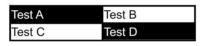

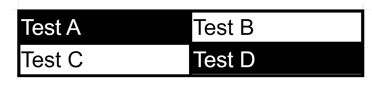

at 180% Zoom, Test A and D cell has a white line despite filling
the cell with black.

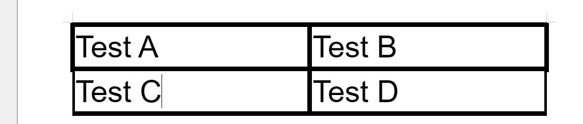

In tandem, when adjusting the thickness of the table borders - there are visual glitches that appear but will correct themselves when scrolling away from the table.

It is just screen artifacts.

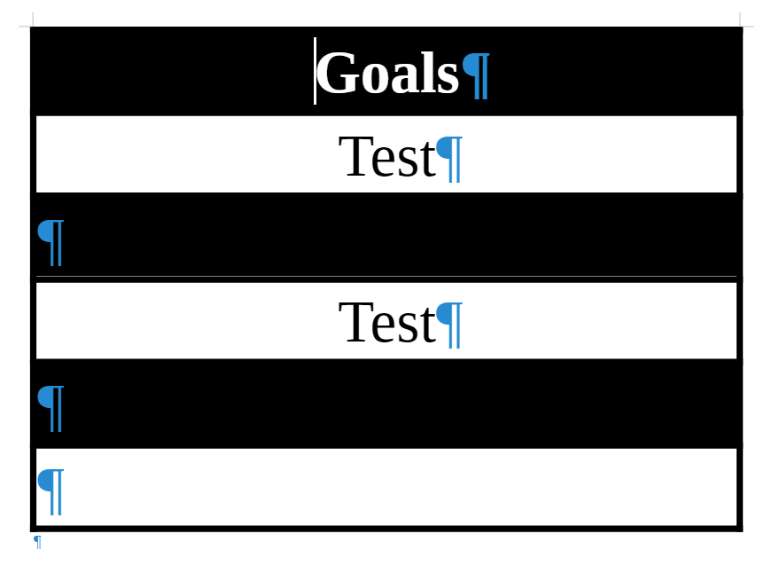

I would like to note, this is not just artifacts my friend.
I printed the document and those lines are very visible.
I even saved as a PDF, opened the PDF in adobe photoshop.
As you can see, in this document here the “cell” is not fully filled. This is clearly a Libre issue.
goals.odt (10.2 KB)
If I export your goals document as pdf, I cannot see the lines in Adobe Reader; I can see lines at some zoom levels in Firefox & Sumatra; I can see lines form and then disappear in Microsoft Edge; I can see lines in Draw but that is not a pdf reader.
I have downloaded your file goals.odt.
Here are my results.
Document view ODT:
Document print view ODT:
131217 HB Dokument ODT Druckansicht
Document view PDF (in Okular):
131217 HB Dokument PDF Ansicht - Okular

If you think so, file a bug at bugzilla.
IMHO not much is “clear” at this stage. LibreOffice runs on different OS, desktops, widget-sets and also there are several ways to generate pdf and the thread shows different pdf-viewers show different results.
I guess this is avwell known effrct in traditional printing, why we design background colours/pictures usually bigger (bleeding in the margin) and add cut-marks. But inside a grid this is more difficult to solve.
A “precise” fill may be rounded a twip to small at some resolutions and showing a pdf may even rely on a programmer to use different sizes for floats and other variable.
In this case it may be “easily” fixable, if an overscen is added so cells would als fill the grid area and the grid has to be ensured to be on top. But as the next user may just swich off the grid one will then have bigger cells and the next complaint lurking…
To avoid the problem I’d try to avoid the combination of fill+border/grid, if possible. Using only fill to highlight should not show artifacts between fill-area and border/grid.
