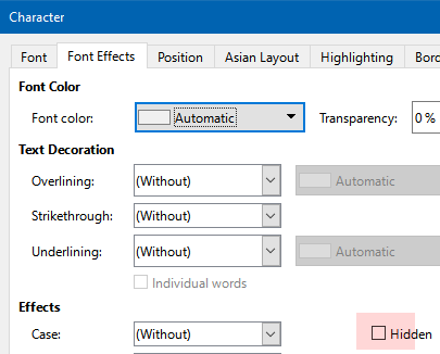

Another workaround: The character font effect of that paragraphs can be set to [x] Hidden, this way there is no need to guess the list number from which to restart.
Take care to define a dedicated paragraph style. I didn’t check if application of a character formatting or style would also affect the “number”. This is why in my hack I told to select from the previous para mark to the next in order to operate on the number.
Hidden has frequently unexpected effects on text flow. A hidden list item is ignored, i.e. it is exactly the same as if it were not present. This means numbering will not be skipped. I had to find a workaround 1 or 2 years ago while helping a user.
